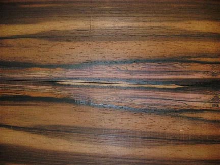

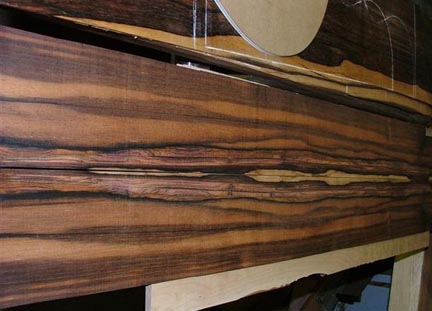

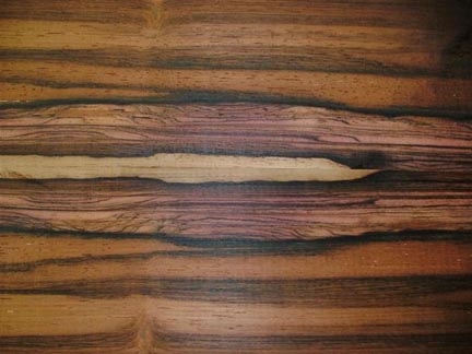

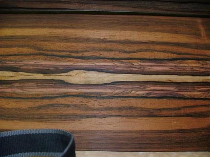

My new Lenox carbide TriMaster blade managed to cut through a 8.5" thick piece of really dense ziricote , and some brazilian rosewood today. Here's a few pics of the Brazilian sides...
Ugly wood, but if someone has to be stuck with it, it may as well be me!

You're right Don, that is some ugly wood......probably totally useless, you should send it to me and I will get rid of it for you!! On the serious side, I hope you get a maximum yield from that stuff.
PostPosted: Sat Jan 29, 2005 11:30 am
Looks like the blade did a nice job. Wood isn't too bad either    What did you learn in school today.....maybe sharing? Don A38381.8128935185

Don, looks like you sawed it straight and true, which I know is a great accomplishment. Nothing like slicing good tonewood.
PostPosted: Sat Jan 29, 2005 11:58 am
I would have liked to try the new Timberwolf carbide blade, but I think they only offer it in a 1" blade. That's simply too much blade for my saw. Eventually I'm going to buy the 20" Grizzly G0507 bandsaw, and then I'll make that investment.
I was very happy with the quality of the cut. I had to do only minimal sanding between cuts just to take out the small irregularities. One or two light passes through the sander and it's ready to go back to the bandsaw.

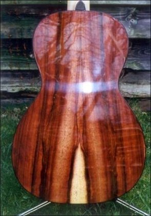

Too late, I just built a parlour from that Brazilian wood.
Sorry about the flash, I must try and take better pics!

I didn't look at the pics real too much when I read the message plus I was on my 1st cup of coffee. But the same question, was the BRW right off the saw or did you toss it thru the sander??
Thanks Gary
PostPosted: Mon Jan 31, 2005 3:59 pm
I think he says he cuts a slice, drum sands the next piece he's going to cut, then cuts another??? But that would be one side sanded, one side not, right off the saw....
I like to sand both sides to see if everything will clear up, eventually.

If you'll look at the top picture, you'll see sanding marks on the bottom piece. The top piece is right off the saw. Sometimes I get a clean enough cut to go right back to the saw, but most times I run the board back through the sander lightly to take out any minor irregularities, which will only be amplified in the next cut if they are left in. Just like Bruce thought.
What suprised me was how easily it cut the Brazilian compared to some cocobolo I cut on Sunday. The cocobolo was a lot more difficult for some reason. Go figure.
